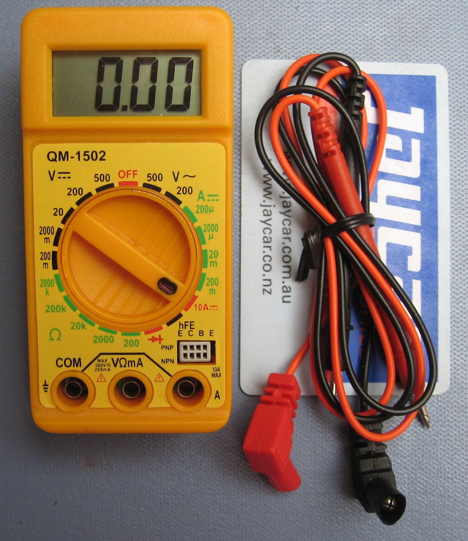

Great little DMMs ! I came up with an auto power off FETlington feature that's worth doing =>
Back in my active PICAXE era I became so peeved by student's "old laptop" woes with costly AXE027 that I eventually sourced dirt cheap alternatives that "always worked". They seem still available (here in NZ anyway) for ~US $2. Stan.
I'd be wary of those. Probably only a third of the ones I've bought over the years have worked, and some of the working ones quit working with driver updates. Nominal PL2303 are particular culprits (because knockoffs).
Sure -"fakes" existed but were readily ID'd. I bought boxes of the "goodies" & gave them away when hassles arose. Note - this was a good decade back when most old laptops ran WinXP or even Win98.

Yes indeed "You can never have too many multimeters"! As a 1960s teen I recall my first analogue one cost -sigh- almost a weeks wages ...
The weakness with these modern DMM cheapies is usually their mediocre leads and lack of auto power off,which peeves when their small 12V battery is found flat AND also contributes to switch wear or incorrect settings. The latter is particulately irksome with "knob twiddler" users... Some DMMs are bright light sensitive too ! I addressed issues with a FETlington slanted Instructable => https://www.instructables.com/Mini-DMM-enhancement/
