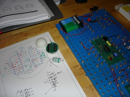

Here are some impressions of our designs:
picture 1: Pongsat, print layout scetch and special battery that fits within the PongSat
picture 2: Project elements: prototype testing model (based on Philips EE system, https://www.kranenborg.org/electronics-philips-ee , with identical circuit)

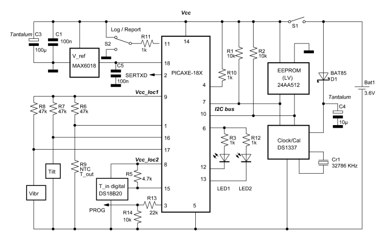

Central to the idea is a PICAXE-18X based flight computer that is designed for very harsh conditions: low voltage due to very low temperatures. The computer is powered by a special Lithium polymer battery that has a guaranteed functionality down to -65 degs C !
picture 3: Circuit diagram
The circuit reveals that the flight computer has similarities with Rev-Eds datalogger kit, however we use different components that can operate under very low voltages (1.8V); the battery can operate at very low temperatures but the voltage drop at low temperatures is considerable as well and may be below the "standard" 2.7V limit.
The computer has 7 sensors (whereof 4 analog), all served by the 18X (how? thanks to hippy's pokings, see the following link: http://www.picaxeforum.co.uk/showthread.php?t=9086 ):
- Internal temperature (digital, DS18B20)
- External temperature (analog, thermistor outside)
- Tilt sensor (internal, requires the pongsat to be in fixed position), to indirectly measure wind effect, obtained via Rev-Ed
- Vibration sensor (another way of indirectly measuring wind speed, also via Rev-Ed)
- Two light sensors (using LEDs with inverse charging/discharging) to measure darkening effect at high altitudes (inspired by wilf_nv, see http://www.picaxeforum.co.uk/showthread.php?t=5945 ). The LED will also be used in a normal way to indicate proper functioning at start-up
- Battery voltage monitoring for measuring voltage drop at low temperatures (Using MAX6018 voltage reference device)
All information will be stored in the special low-voltage 24AA512 EEPROM with an interval of approx. 20 secs.
As you can see development is at full speed now (I'll do mostly hardware, Joost has begun programming, we do the prototype model together), we'll come back soon with a lot of issues that we would like to get help with. Meanwhile we are open for any discussions on the design!

Whoo, that sounds like an amazing adventure to be involved with and good luck. I'm sure it'll take pride of place on the mantlepiece once it's been into space.
Probably late in the day but a few thoughts ...
Do you need the RTC ? Use on-chip Timer 1 with the 32kHz as a Low Poer Osc and you can probably get an as equally accurate timebase / timer. That saves space and reduces current drain.
Can you sandwich the PICXE between the R's ( on top and underneath ) ? That may give a little extra heating which keeps the PICAXE going for a little longer.
What about a low-R which does work as a heater under the PICAXE ? You could drive that via PWM to adjust the temperature. Nothing to lose by draining the battery quicker if it eeks out a few extra seconds of PICAXE life.
A compact design with components under/over each other, vertical R's may give a smaller core, small enough to get two batteries in there if lucky. SMT might help, an SMT PICAXE could perhaps be easier to keep warm ?
Maybe a dead-bug wiring scheme would be even more compact but more fragile.

Hippy: Your reactions are highly appreciated, here is the response to your remarks:
I have considered this option (as I currently need to place the MAX6018 voltage reference somewhere hanging in the air), but Timer 1 use requires pins 12 and 13 for the 32786 Hz crystal connection and these are exactly the extra ADC pins available when poking port B ... . I prioritized the option to use the two LEDS as optosensors, but I was close to choosing the timer use and thus saving circuit board space.
We have thought above the above options in a similar way, primarily opting for battery heating (max 50 mA can be drawn from the types used, but this may be less at lower temperatures, thus a control strategy is needed) using mosfet-switched resistors and using special IC sockets with pins sideways and connecting these together around the battery, thus maximizing thermal radiation heating (most of the air is gone, so radiation may remain as the most inportant thermal transport process). However, this approach makes it very difficult to add the various extra components (Still a lot of them, it is a pity that only port B supports programmable pullups, whilst I need them at the "official" inputs at port A) and I am very limited in the soldering tool sand experiences. The idea of use of SOIC parts is an interesting option however I did not take into account.

The second picture shows the effect of light on the two optosensors. The pink graph shows the results for the LED that picks up light from a broad field, whereas the blue graph shows the one with a straw mounted, such to avoid direct sunlight or reflections entering (the dips show that it happened though) and to register the darkening of the background sky only. A lower value implies that more light has been registered (discharging the LED capacitance). The blue trend arrow (as well as the different orientation of both arrows) give a suggestion of the registration of the darkening effect (given the fact that semiconductors get more efficient at low temperatures the difference in trends is even more markedly). The effect seems to set in somewhat early though, but the suggestion is clearly there. In the current implementation the exposure time was fixed (see the code attachment earlier in this thread), but this may be calibrated in a more intelligent way.
Finally, the only sensor that has not functioned well is the external NTC temperature sensor. It has probably become too hot during soldering and would need to be replaced.
All in all it seems to have functioned remarkably well, and given the richness of the current dataset and the potential for software improvement (particularly concerning the optosensors, there is still much codespace left to do autocalibration during the flight in order to have the trends development much clearer) I am considering the option to let it fly again and see whether the analysis done so far holds. I think the current flight has shown that the technology mix used is very appropriate for this type of experiment. (would be great to get someting like this even in their rocket experiment!)

i was wondering tho, the change in temperature must have somehow affected the ICs. At -50, -60C there must be some deviation in say the operation of clock so the accuracy of frequency must have been affected?
i wonder if these electronic components work the same at those extreme temperatures.

I would think that the low temperature would effect the photodetector reading. Its probably worth mounting the sensors and conditioning circuitry in a domestic freezer to check the level of drift with temeperature.

You mentioned that some of the sensors may have elevated temperatures because exposure to sunlight.
Can you take advantage of any absorpsion by painting the external of the Pongsat with a flat black paint. I guess any elevation of temperature would be beneficial.

Hello,
As I see it the reply of vk6kci includes an implicit proposal for a comparative experiment using three PongSats, namely a white one, a black-painted one (inside and outside) and one wrapped in aluminum foil! These would all have identical circuits registering the internal temperature (a 08m with a DS18B20 would be sufficient, maybe an extra DS18B20 for the outside temperature a well). Looks like a very simple experiment but since most of the air will disappear high up in the atmosphere, it is the more complex thermal radiation process that will determine the temperature of the components inside the ball, thus delivering an actually interesting experiment. If we (my son and I) would make for example the black one, any volunteers then for the other ones?
The temperature will defiitely affect the optosensor reading, therefore I will put some aluminum foil around the straw when we will try to let the NLSE-1 fly again.
The crystal frequency will be dependent on the temperature as well, the crystal frequency is specified at 25 degrees C, any deviation in temperature (positive or negative) will lead to a lower crystal frequency. Since in our circuit the reading instant of the clock is determined by the picaxe timing (with possibly a different temperature behaviour as compared to the crystal), maybe the deviation between the pic oscillator and the crystal may be recovered as well, I'll have a look later on.
